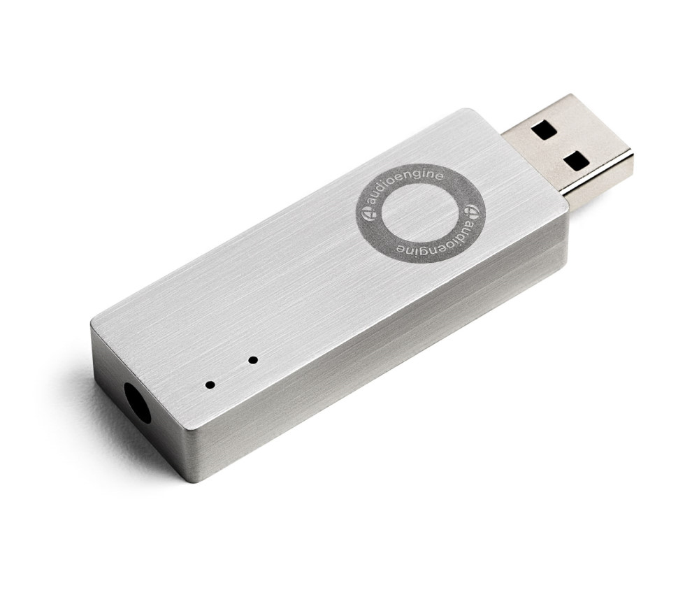

【新品】Audioengine D3 Premium 24-bit DAC
越來越多類似的產品了
USD 189

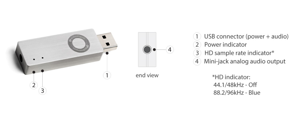

Features
Portable USB audio converter for Mac or PC
Stream bit-perfect native 24/96 HD audio
High-performance headphone amp included
Plug-and-play, no drivers or software to install
Connect headphones or any music system
Easily drives low impedance headphones
Computer OS volume control
Asynchronous data transfer with dual master clocks
HD indicator for sample rates above 48K
Metal injection molded (MIM) aluminum case

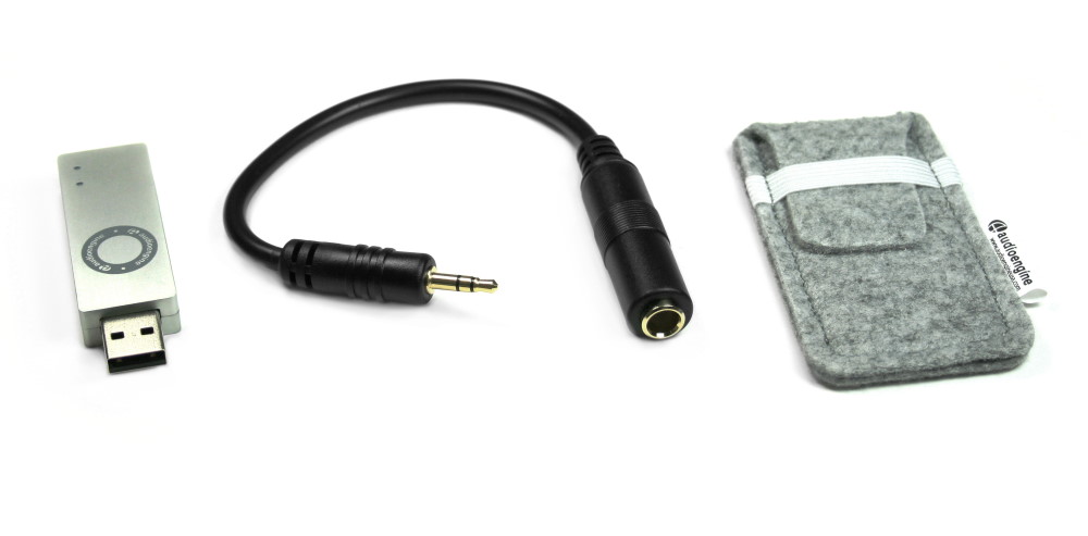

What’s in the box
D3 DAC
Carry case
1/4” headphone adapter cable
Setup guide
Product line brochure

Included accessories
1/8" to 1/4” adapter cable
Product case
Setup guide
