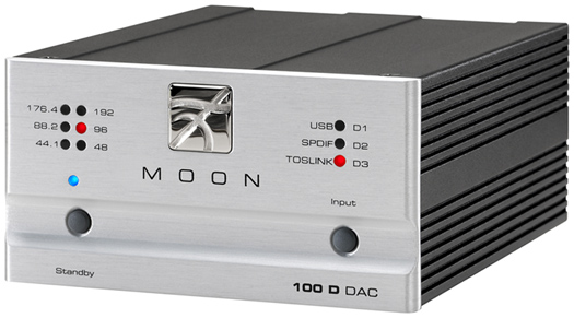

    沒想到正在聽MOON 300D,Simaudio就發表更入門的100D,跟300D比,100D少了一組SPDIF,然後沒有類比平衡輸出,內部線路也較為簡化,改為DC變壓器供電,不過一樣使用 BurrBrown PCM1793 的晶片,可支援到24Bit/192kHz(USB為16Bit/48kHz)
    Significant Design Features:
    · Power supply with 3 stages of DC voltage regulation
    · A fully asynchronous sample rate converter
    · BurrBrown PCM1793 high-resolution 24-bit/192-kHz D/A and 8X oversampling
    digital filter
    · Accurate digital clocking system for exceptionally low intrinsic jitter levels
    · Single-ended RCA analog outputs
    · Advanced analog signal path using a DC servo circuit and proprietary analog filter
    · Pure copper circuit board tracings with extremely low impedance characteristics
    · Extremely rigid chassis construction to minimize the effects of external vibrations
    · Accurate matching of high quality components in a symmetrical circuit design
    · Designed to be powered up at all times for optimal performance.
