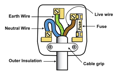

    Circuit Design: Finally, there's the wiring inside the plug itself. Not only is it extremely intuitive, but it has been thoughtfully designed so that if the plug is tugged and the wiring frays, the live and neutral wires are the first to become disconnected, while the grounding wires--the ones responsible for preventing human electrocution when they come in contact with a circuit--are the last to fray.
    It's a truly brilliant design. The only caveat is that, as with Lego, the rugged, bottom-heavy design of a U.K. plug makes it an almost scientifically perfect caltrop.
    插頭內部線路設計,中、火線會先斷,最後才是地
